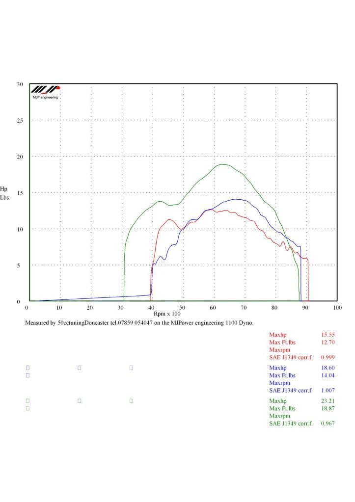

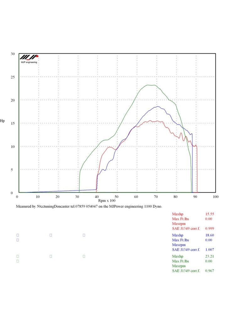

heres 1 i did this week 225 mugello 4 port, customers scoot wouldnt pull 4th approx 4.6 gearing so was considering a gearbox/gearing change, i said for similar money id tune it to pull the box
despite peoples concerns i thought the port durations were quite good but the port areas were mismatched and improvements could be made here and there to port angles ,the top end was fitted with a cheap piston which had thick cast rings so limited port width to 65% bore ,i reset the top end with different gaskets to obtain improved compression and squish clearance.i mainly ported the exhaust port only to suit mildly revised transfer and inlet durations ,this runs a jl3 exhaust and 30mm carb
standard gasket areas remain on inlet/exhaust and base gasket as no power gain to be found there
the 3 graphs are the std built motor from camlam in red 15.55 hp 12.7 torque(nice build just jetted safe)
the same motor after setting up on the dyno in blue 18.60 hp 14.04 torque
the same motor after stripping porting rebuilding 23.21 hp 18.87 torque

Darrell Taylor wrote:heres 1 i did this week 225 mugello 4 port, customers scoot wouldnt pull 4th approx 4.6 gearing so was considering a gearbox/gearing change, i said for similar money id tune it to pull the box
