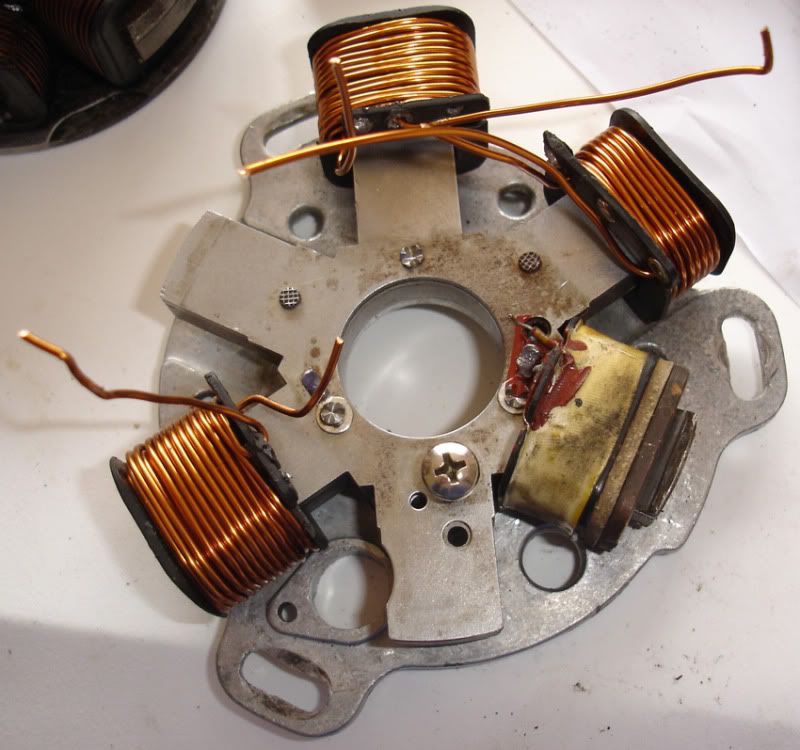

I must say that what WCW did to your stator may work, but what a mess :-?
soulsurfer wrote:I must say that what WCW did to your stator may work, but what a mess :-?
It did work briefly but then it wouldn't start and was reading open circuit on the LT coil. Much pulling and poking eventually revealed a break in the green close to the LT coil but by then I'd lost faith in the thing and WCW :roll:
Couldn't agree more Mike. As a time served electrical fitter, it was one of the jobs we had to do during my apprenticeship at H M Dockyard Devonport, and if I had turned that stator in to my instructor, I would have got a bollocking.p155 poor craftsmanship.

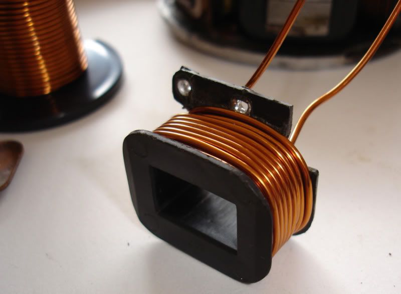

As mentioned above, Adam was true to his work and kindly sent me some pictures of the stator that he re-wound some years ago. It looks to be amazingly neat especially as he did it using a pencil and his foot as a tensioner. I just hope mine are as good.
The wire used looks to be at least one size bigger that the 2 stators that I currently have which is a shame as the spool of wire I have ordered is also that size :oops: Hey ho, it's all experimentation and J1MS has given me food for thought with the parallell windings. I think I will bring all of the coil wires outside the mag housing so that I can swap between parallell and series connections.

soulsurfer wrote:Ahah, another HM Dockyard apprentice eh? I was a Chatham Dockyard apprentice, transferred to AUWE Portland when Maggie closed Chatham ;-) Obviously an eye for detail :lol:
pah dockyard apprentices. armament depot was the way to do your apprenticeship. i was an apprentice fitter/turner but we could turn our hands to anything, i rewound a set of rally stator coils to 12v when i was an apprentice and it was much neater than the stator shown here and i wasnt even a leccy.

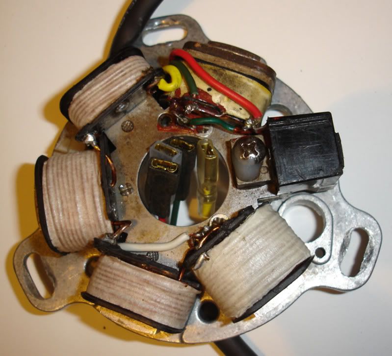

^... Colin, thanks for posting the photos. I've had zero chance to upload them to a host site, etc. so do appreciate you posting them. However, would it be rude of me to point out that photo 2 seems to have been posted twice? That said, it took me 20 minutes of playing 'spot the difference' before I realised that it was the same ;)
WCW... yeah, looks a bit half-hearted!
