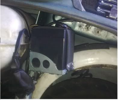

here's mine
that's a 4.5Ah battery, which is ample for running stanard lights.
it is also bolted to the rear muguard
can anyone tell what i made it from after looking around the workshop for a bit of metal of about the right size...?
i can ;)
but you did tell :oops:

byron wrote:here's mine
I cut out a cardboard dummy 4.5AH battery to see if it would fit and it looked a bit tight. Clearly I was wrong! Still, no matter, I haven't had any battery at all for the last umpteen years and its never been an issue.
