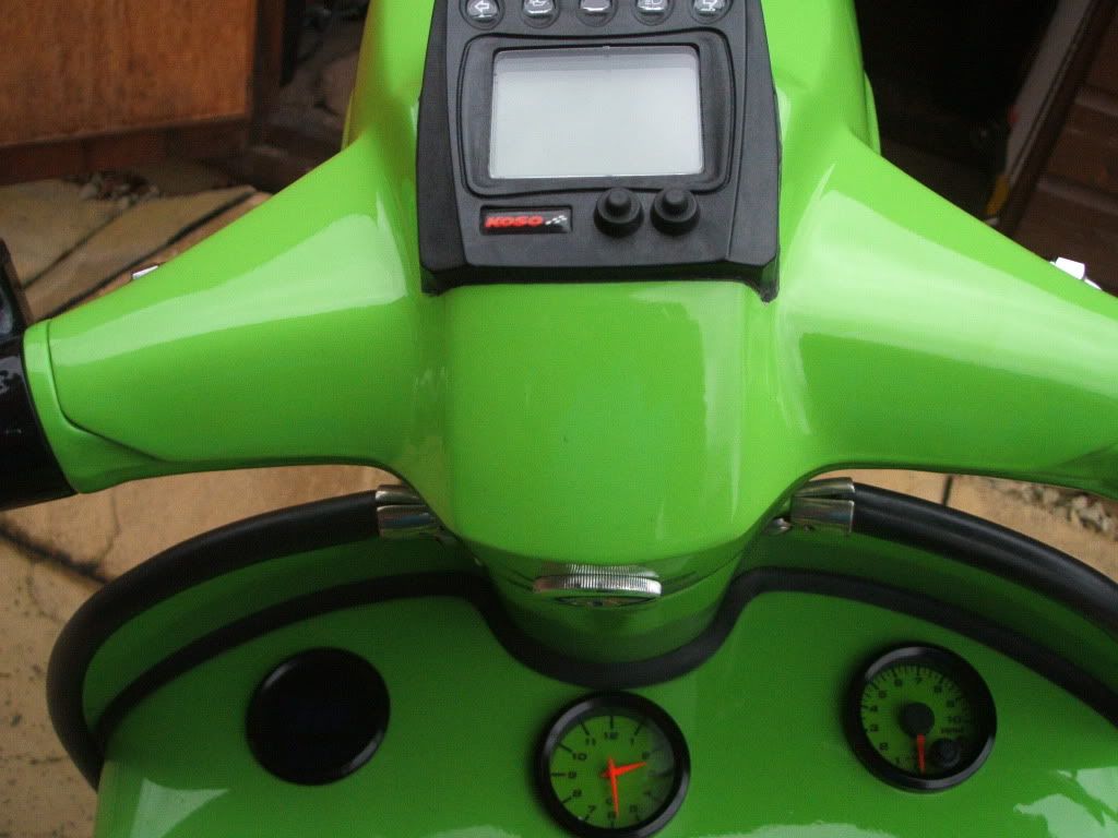

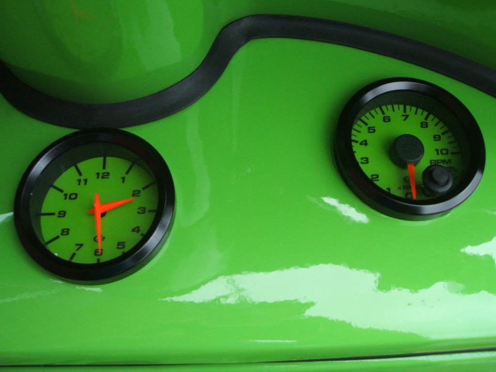

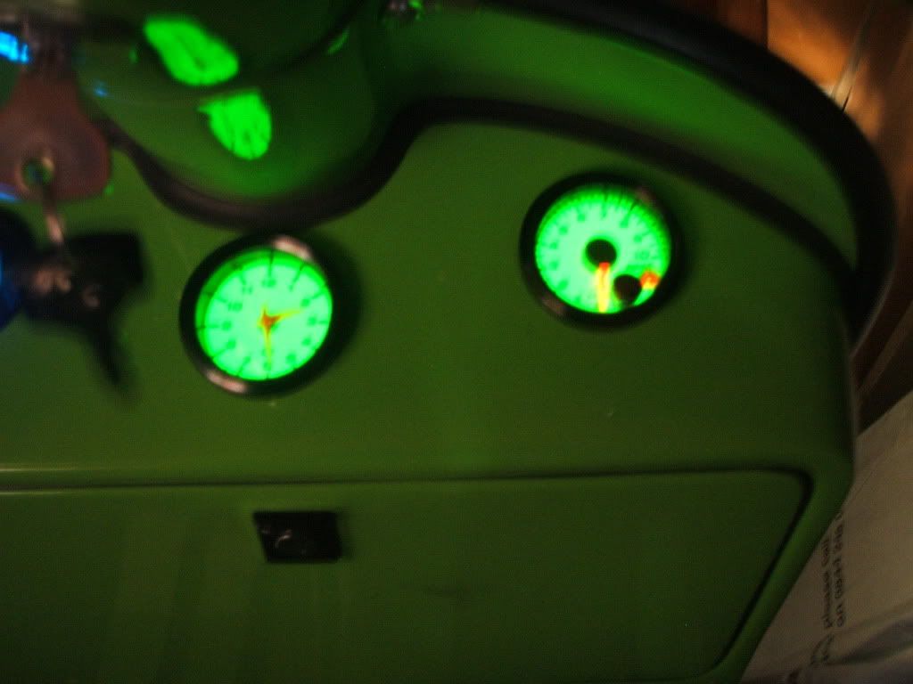

Speedhut gauges are a quality bit of kit.I have just fitted a speedhut clock and rev counter and had them done to my own spec and colour etc and the rev counter worked 1st time and works perfectly:
I have ordered the 'speedhut' gps speedo :
and will be replacing my existing koso one. as this is ok but dosen't always work properly and i have to keep messing around with the wheel sensor. I will keep you posted on the gps antenna position as i know with my sat nav in my van it needs to been in front screen area or it don't work properly as for fitting it in the headset i will let you know..
