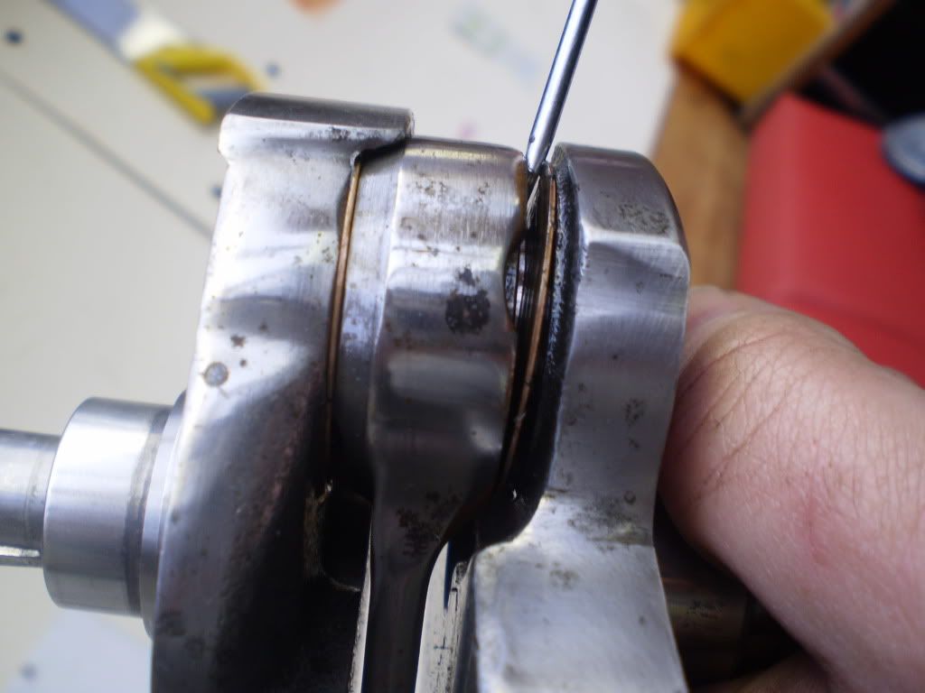

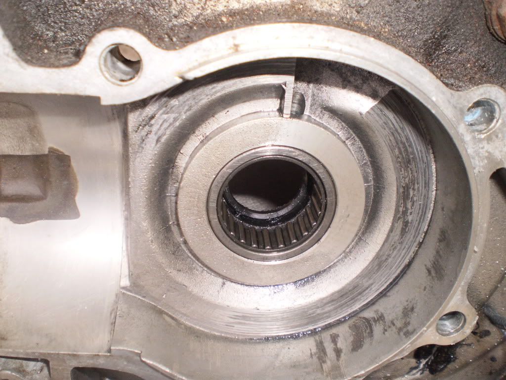

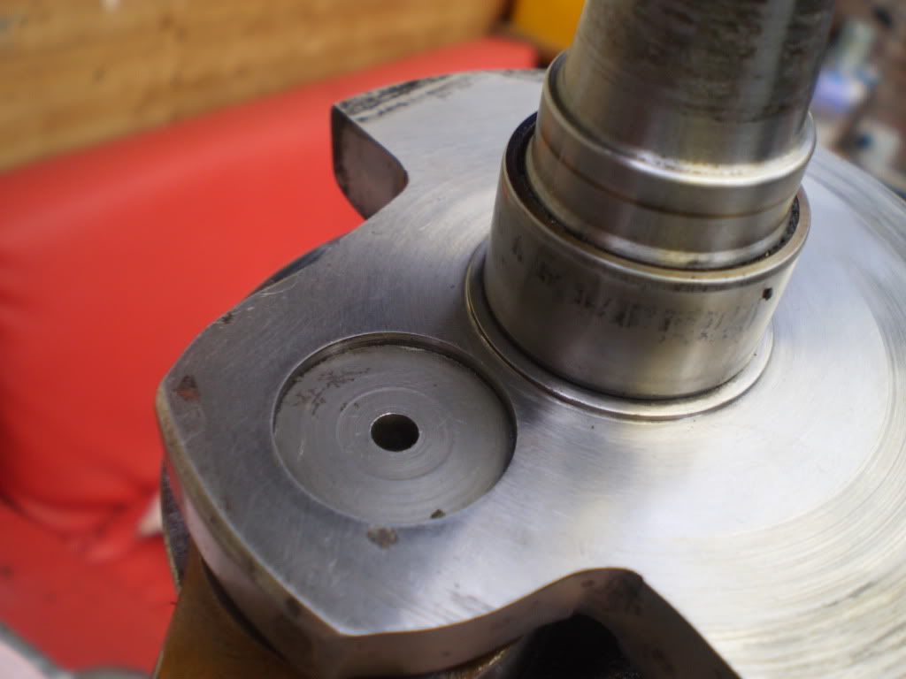

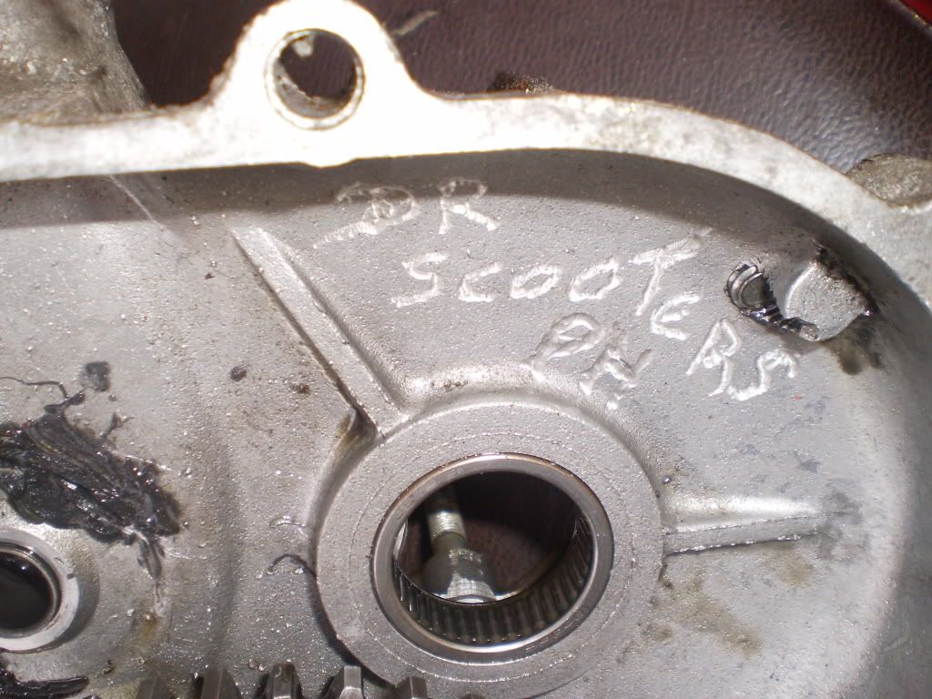

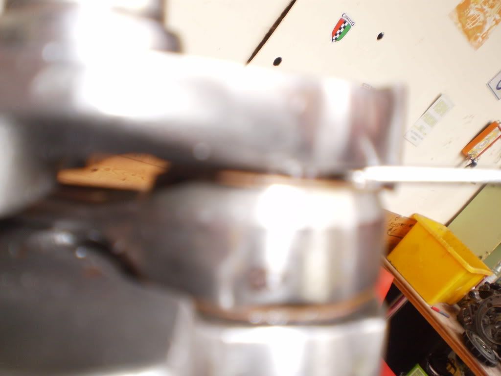

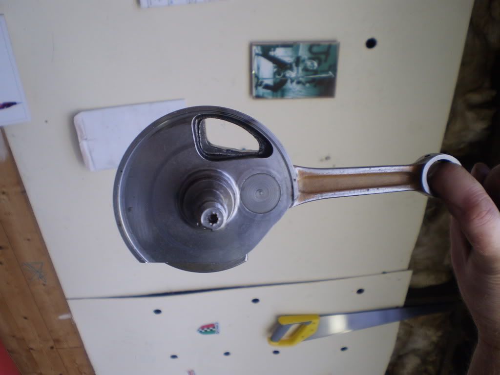

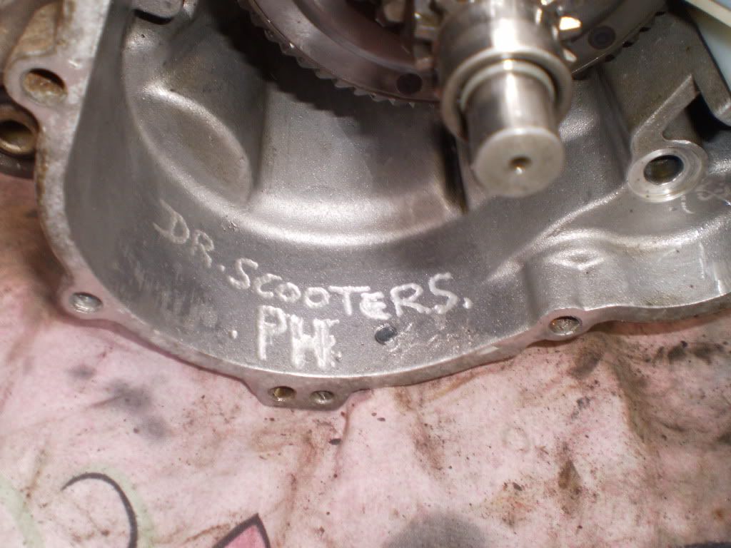

hi an thaks everyone above , yes im a novise when it comes to indepth tuning ive done malossi 210,s in the past more or less on standard form tho standard carb , crank , an sum form of pipe an alittle porting on the casings just to clean it up abit, anyway this engine has alot more done to it , it has a pm pipe , 28 mil spaco an ported casings in pics above split engine today an took a few more pics i found that it had DR SCOOTERS an the letters PH engraved inside , also ive found some scoring on the flywheel side of the casings an on the crank has been rubbing also had a look at the crank an seen this is this crank fecked see pics thanks

i have since been told that the fella that originaly built this engine an done all the porting work worked for dr scooters then left to setup on his own an is now JB tuning or so im told
