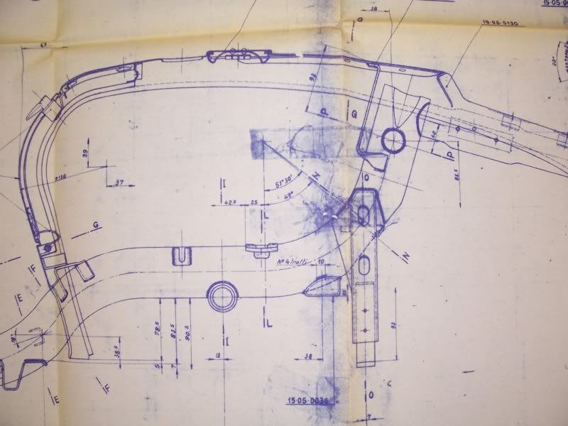

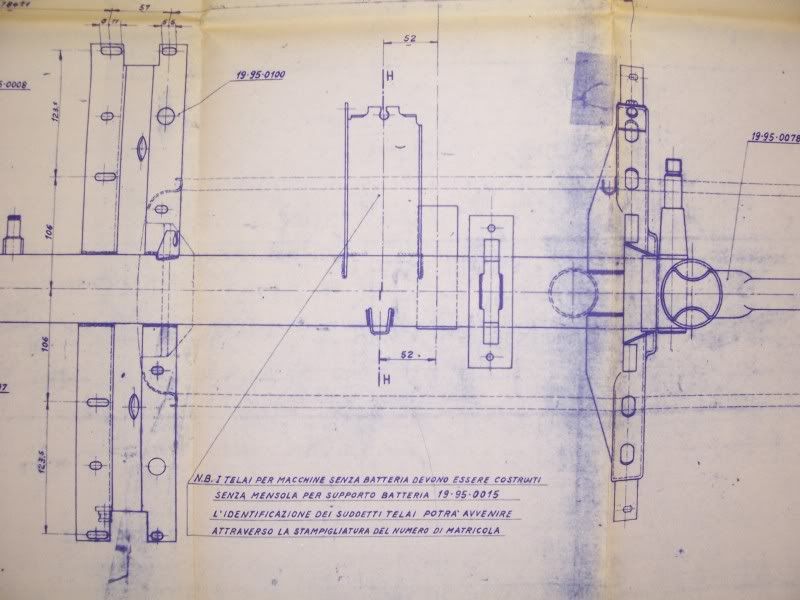

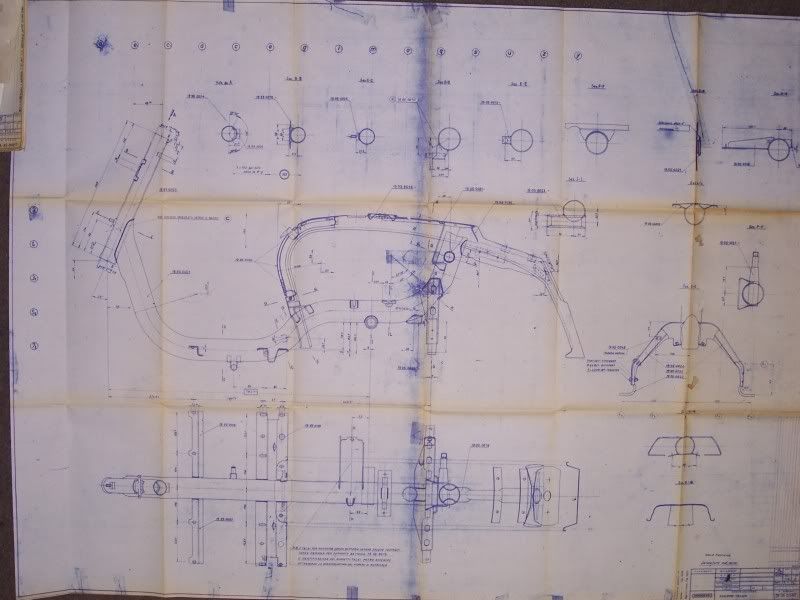

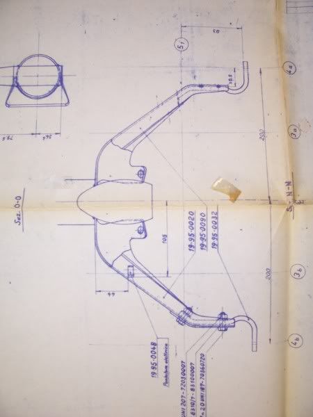

sorry for slow reply ile try find the propper paper ones (havent seen em for years)
hope they help :bigsm:

And many thanks for the pics of the drawings. Hopefully from them i can work out some angles and sizes.
Then start drawing things and get stuff water jet cut out.
