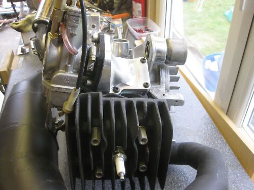

MZ cylinder head for Lambretta 200cc
Out of interest, what power is you scoot pumping out wezley and what weight is your finless flywheel?
wezly
Posts: 71
It made 32bhp on JB's Dyno, flywheel was machined to 1050grams. Its a parmakit ignition.
Good stuff, thanks. Well that shows that a powerful/tuned motor can be cooled efficiently with a decent head alone then.
And you have no problems with overheating round town and at slow speeds etc?
Do you use any additional air scoops n such, or just standard bodywork?
am i correct that ts1(and others)are hottest at the exhaust side of the barrel and as such seizures tend to take place here ? ,would there also be any benifit in extending the fin area in that area on the barrel ??
also ...would this be illegal in bsso ??
wezly
Posts: 71
Hot around town? The engine doesn't make any real heat until it comes on pipe, i can come off a motorway and leave it ticking over couple of minutes and then hold the head. No extra scoops are needed, iv'e never seen the temp pass 90 on an engine using this setup.
I quite fancy this setup, had a peek, MB out of stock....... :o(
mz head are a bit thin on the ground too on ebay ....perhaps a air cooled kdx or similar would suit :? :wtf:
