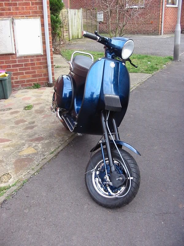

I flaked my vespa and was the first time of trying as a novice, satin black base coat then blue flake off ebay. Word of warning though after two years ive noticed that the flake on exposed parts has lost most of its colour compared to the blue flake under the panels. I used a binder to put the flake on then 2pack laquer. I didnt fully finish it though cos I new I was gonna mess it up so could have done with a few more laquer coats.
