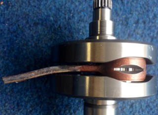

by drunkmunkey6969

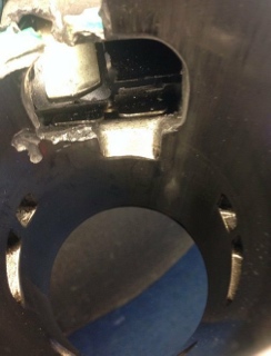

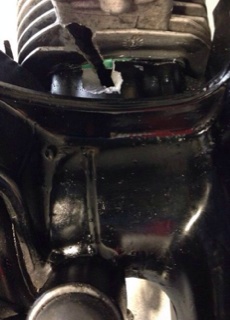

Advertised as a race crank best served on TS1 and RB engines, the said crank from PM Tuning failed after circa 20 miles.....slicing through the casings, kit and reed block.
PM upgraded the crank to the 116mm rod version after I contacted them, the rest of the cost was met by myself and the customer.
Steer clear of any Tameni made cranks with 107 rods!

It's also a problem with the MEC Vespa P200 cranks too (mate's Rally engine sliced in half), and the old black-webbed Lambretta race cranks, both of which used to be great. Something up with Tameni's rod quality now, don't know why but it's not good news.

Thanks for the info as I was considering one of these very same cranks, having identified it as good VFM. I already have one (unused) of the PM 62mm cranks with 116mm rod, but that rod is the machined silver coloured rods, which I hope will not suffer the same sort of failure as the different spec 107 rod pictured.
Having had the back of the big end break away on a MEC race 58mm a couple of years ago, which again punched a hole straight through my otherwise perfect 200 casing (!), so I don't really want to go down that street again.

ive found the tameni cranks to be excellent ran them in my race group 6 but after a few meetings had the silver af/pm 116 style rod fail but also know that meeting it was overrevved and downshifted which kills rods and still have lots of guys running the cranks in high horsepower motors a few years down the line without issue ,there are some i avoid that are sold that have the gold 107 conrod with the very small cross section below the small end eye fitted to whats known as the black mec eur cranks and the pm one that dan had go and always the same one on many pictures you see floating around of failed rods ,also seen a few top racing and bgm version weighted cranks of late with drifting balance weights causing major fails ,so i try to stick to 1 piece tameni webs60 62 64 there tight on the pin and well proven in race and sprint motors and jap rods/mx rods to suit 110 115 118 120 125 16 and 18 pin
