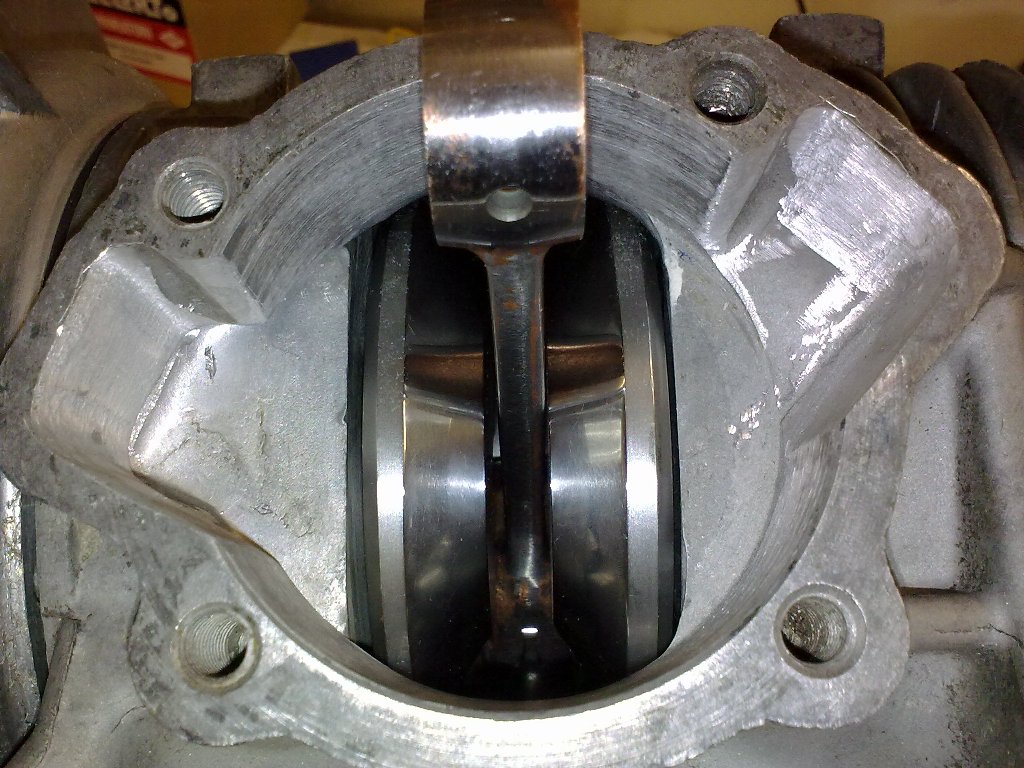

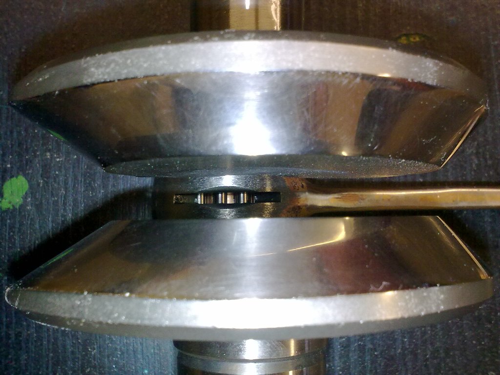

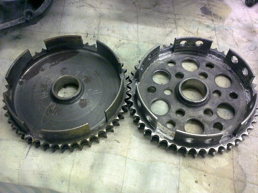

Engine build is underway.....i've cleaned up the casings (cleaned not blasted) fitted hi-load bearings and seals, fitted n shimmed the gearbox, layshaft, selector etc, drilled out the clutch basket to lighten it, dremmeled down the lip to accommodate 5 plates and had the spider welded. Sean has ported casings n crank beatifully (see crank post), and i've now slotted the crank in, fitted the mag-flange, got everyting torqued down, and am sorting out the gearing/chain/clutch etc next. Then i can slot on the top end and check the port timings so Sean can then port the cylinder.....so we're a couple of weekends off being ready yet, but its taking shape. Road/race frame should be delivered end of this week....

It was when we started.......but as you can see...its been modified by Sean.sydduckett wrote:drunken, is the crank you have there the one that AF reccomend in there ad "RB20 Race Crank 116mm rod" for the RB20 kit they have on there site?
