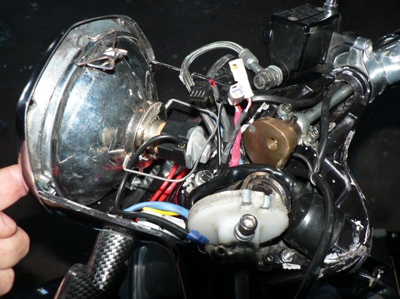

Apart from getting a better light, one of my objectives (I have a SIP speedo, hydraulic brake hose and indicators attached to the headset) was to get a little more room in the headset.

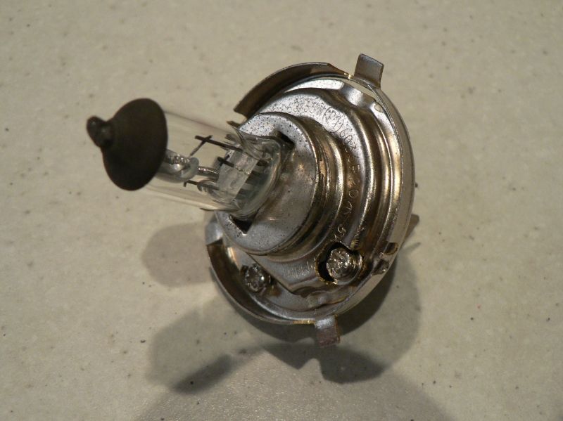

First thing was to check the focal lengths of the old BA20 bulb and the new H4 to ensure a half decent beam pattern with a standard reflector/headlamp glass. This worked out quite well by removing the metal collar from the old bulb holder (a CEV type) and modifying and the H4 bulb like this:

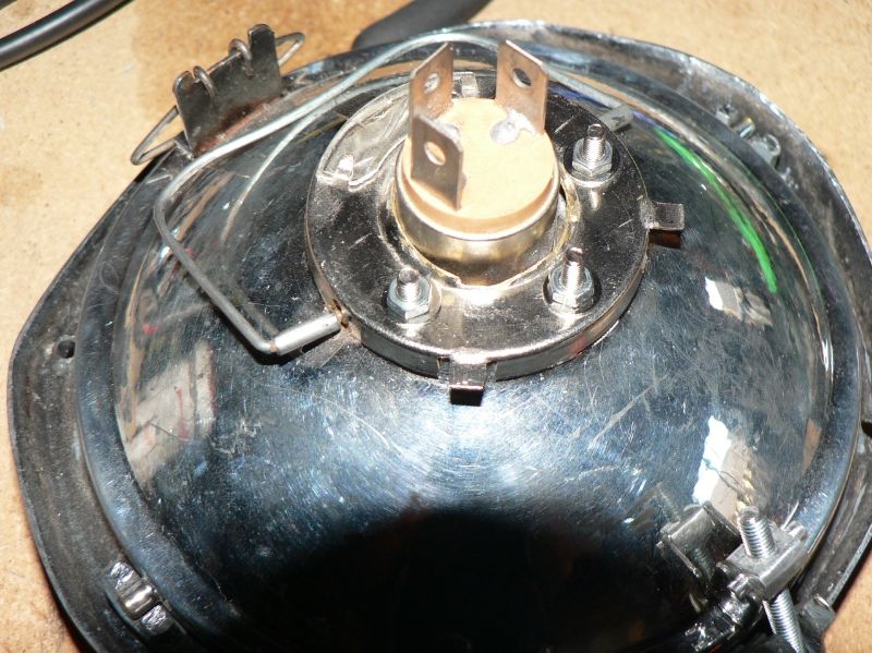

This is how it now looks mounted in the reflector assembly:

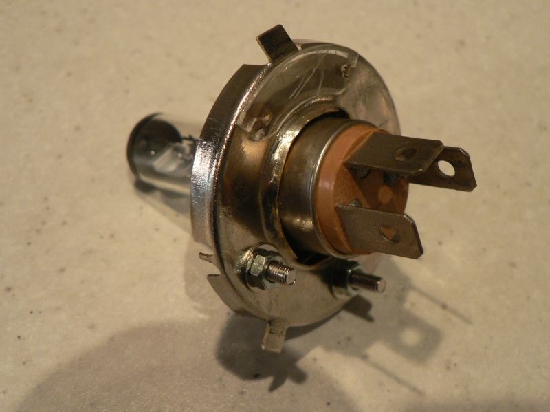

I sliced off the back end of the original bulb holder and used JB Weld to glue it to the back of the H4 connector, so I could use the original spring clip fixing:

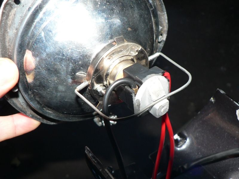

And this is how it fits:

Today is final assembly day so I should see if anything shorts/melts/blows up very soon! :lol:
