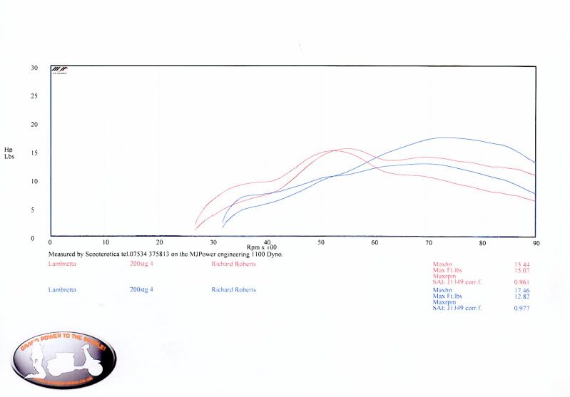

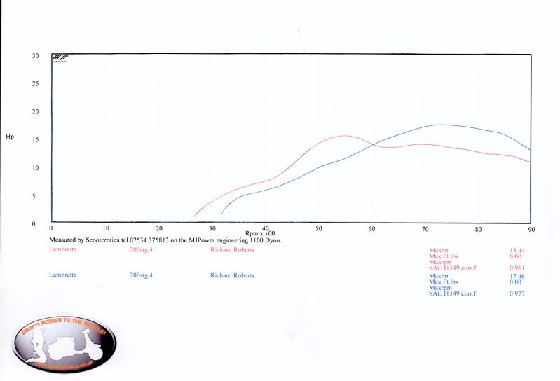

So we ran it up on the dyno to get a base reading, and i've got to say....in standard trim, the results were pretty good:17.5 bhp and 12.8ft-lbs (blue lines). Then we tried the Adspeed pipe and it did what he said it would do.....it bumped up the torque and stuffed it lower down the rev range, although it did knock a couple of bhp of peak power and altered the delivery curve somewhat: 15.4 bhp and 15 ft-lbs (red lines). I've got to say, with regard to this alteration of power delivery, i prefered the original (blue lines) for my style of riding, and didnt like the way the bhp dropped and flattened off after peak power was made.....the power curve looks weird to me, but someone wishing to 'de-rev' and up-gear may like it.
Below: Comparison of both pipes, bhp & ft-lbs
Below: just the bhp comparison (KRP2 17.5 vs Ads 15.4)

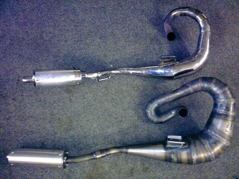

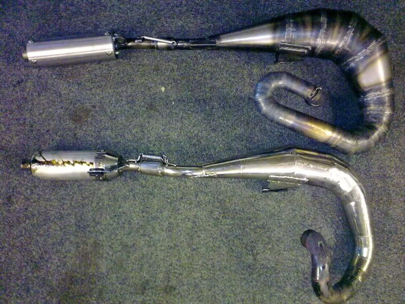

Image of actual pipes:

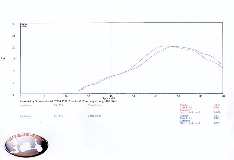

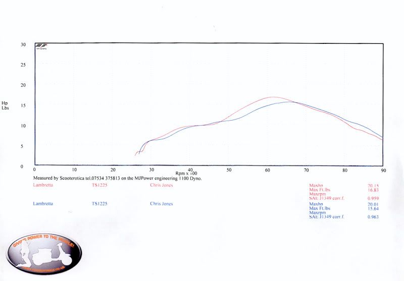

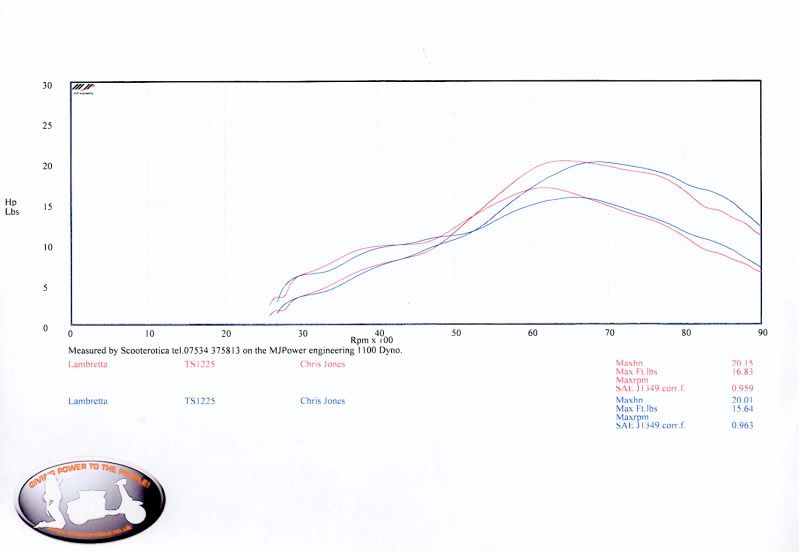

So having done that test, we then got a TS1 through the door, standard trim, 35mmTMX carb, JL3 pipe......and the results were much better. This is what i consider to be the 'it does what it says on the tin' graph! :lol: By that, i mean that Ads said that on a 'fruity' machine (say a TS1 or RB etc) where somemone wants to keep peak BHP, increase ft-lbs, bring both peaks lower down the rev range and up gear......this is the best application for this exhaust. Original trim it was 20 bhp & 15.6 ft-lbs (blue lines) but with the Adspeed pipe it was 20bhp & 16.83 ft-lbs. The difference being this time, that peak bhp held, ft-lbs increased, but more importantly the shape of the graph improved. Both bhp & ft-lbs were delivered earlier, and both managed to hang on in a very similar manner to the JL3. So TS1225, JL3 vs Adspeed:
Below: Comparison of both pipes, BHP & ft-lbs
Below: Just BHP comparisons (JL3 20 vs Ads 20)
Below: Just ft-lbs comparisons: (JL3 15.6 vs Ads 16.8)
So all in all, from this fairly limited test i've done, i'd say that a machine in a low state of tune will not benefit from this pipe nearly as much as a cylinder which is in a higher state of tune. And if you have such an engine and your goal is to re-gear for a more touring type of ride rather than a revvy-racer type of ride, this pipe should certainly be considered. Its a bit cheaper than a JL3 and seems to give better touring capabilities on tuned engines.

If you imagine this pipe is kinda targeted at the rally going geezer I'd like to think the results for the Stg4 barrel are quite promising. If you look at the actual rev range in use say 3-7k then I'd like to think the ADS out performs the JL2 and if you regularly rode two up then theres only one winner. Gotta say from what I know about the JL2 its quite a revvy little fella so maybe a little chalk and cheese......
Standard TS1 results pretty much as we expected really......... :)
From experience (road and dyno)the ADS3 will not rev as high as shown so just trying to get my head round the later halves of the graphs. I only mention this as the graphs show them revving in excess of 9k and want to point out to potential purchasers that it ain't gonna happen.......Dan and I are just scratchin our heads with this at the mo..........

Very interesting. I think one of the most surprising things here is the two photos above of the exhausts side by side. They look so radically different. The volume of ADS must be twice that of the KRP2, yet the results are not hugely different. It really just demonstrates the complexity of designing an exhaust.
