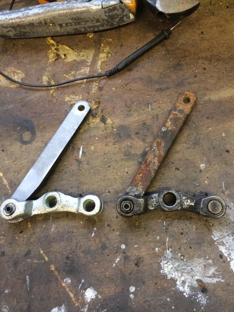

Adam,just been out to garage to check that and it's fine.But what I did do was disconnect the new flat bar that connects the selector arm on the gearbox to the thing that is attached to the cables.What I found was the bar is binding with the bit at the cable end,thus limiting travel.I have to go out now,but when I get back I will have a good look and post some pics.I am sure this is the problem.
dave411
Posts: 360
Main scooter: Li 125
Location: Cardiff
http://i1197.photobucket.com/albums/aa4 ... d699jm.jpg
This is the problem.As you can see,the new one on the left is limited in its ability to move over to the right.
http://i1197.photobucket.com/albums/aa4 ... d4ktuf.jpg
Its difficult to see,but the slot in the new part isn't as deep as the old one.Crap parts again.
http://i1197.photobucket.com/albums/aa4 ... emt1x4.jpg
So,out with the file to make it work.
http://i1197.photobucket.com/albums/aa4 ... jhc4bp.jpg
And here we are,same angle,hurrah!!!!!!!!!!!!
http://i1197.photobucket.com/albums/aa4 ... rcy8va.jpg
All back together and working perfectly.

How frustrating to have to modify it to function correctly!
Adam_Winstone wrote:How frustrating to have to modify it to function correctly!
It is annoying, I had issues with a cheap ebay selector fork which needed a LOT of grinding to allow it to rotate without fouling and 2 selector lugs that needed a fair bit of filing to slide in the selector. That said, it is the best gear change I've ever had, virtually no play 8-)
